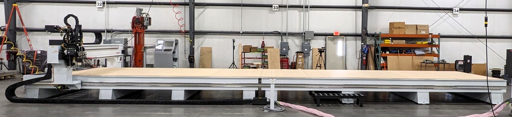

Thermwood MAX5 15'x45' CNC Router
This 5 axis machining center handles large and massive components with ease. With 9 feet of Z axis clearance, widths of 10 or 15 feet and lengths up to 60 feet, the MAX5 machines complex parts in a single setup, saving time and simplifying production.
  • 9' Vertical Z Axis
  • Width 10' or 15' - Lengths up to 60'
  • 17 HP Liquid-Cooled Spindle
  • 6-Position Automatic Tool Changer (Standard) or expandable up to 18 Tooling Positions
  • Automatic High-Tolerance Tool Length & Diameter Measurement
  • Thermwood SuperControl with Smart Router Technology
  • Machine Indexing Speeds up to 2,100 IPM
  • Engineered Steel Vertical Support Columns and Stress-Relieved Gantry Weldments
  • Precision-Machined Steel Plates & Internal Steel Bracing
  • Optional Floating Work Table with Drilled and Tapped Aluminum Surface
  • Free Lifetime Phone, Forum, and Email Support
  • Lifetime Machine Support from Thermwood’s Legendary Service and Support
From large-scale molds to aerospace parts, the MAX5 keeps your production running smoothly and is backed by American engineering you can trust.

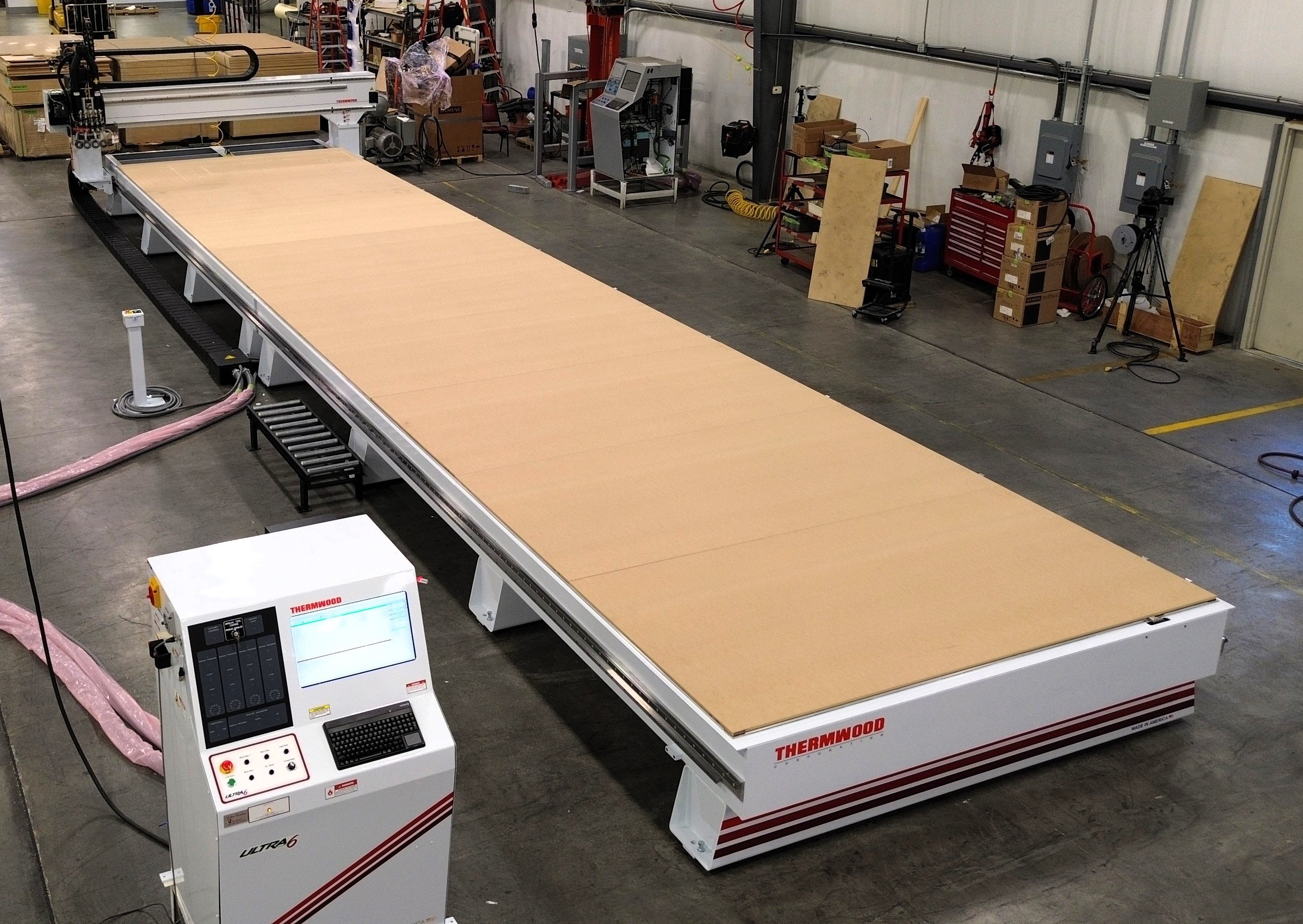

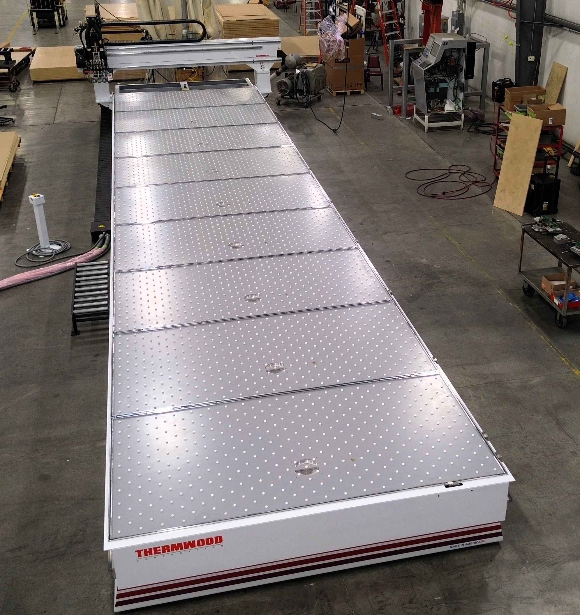

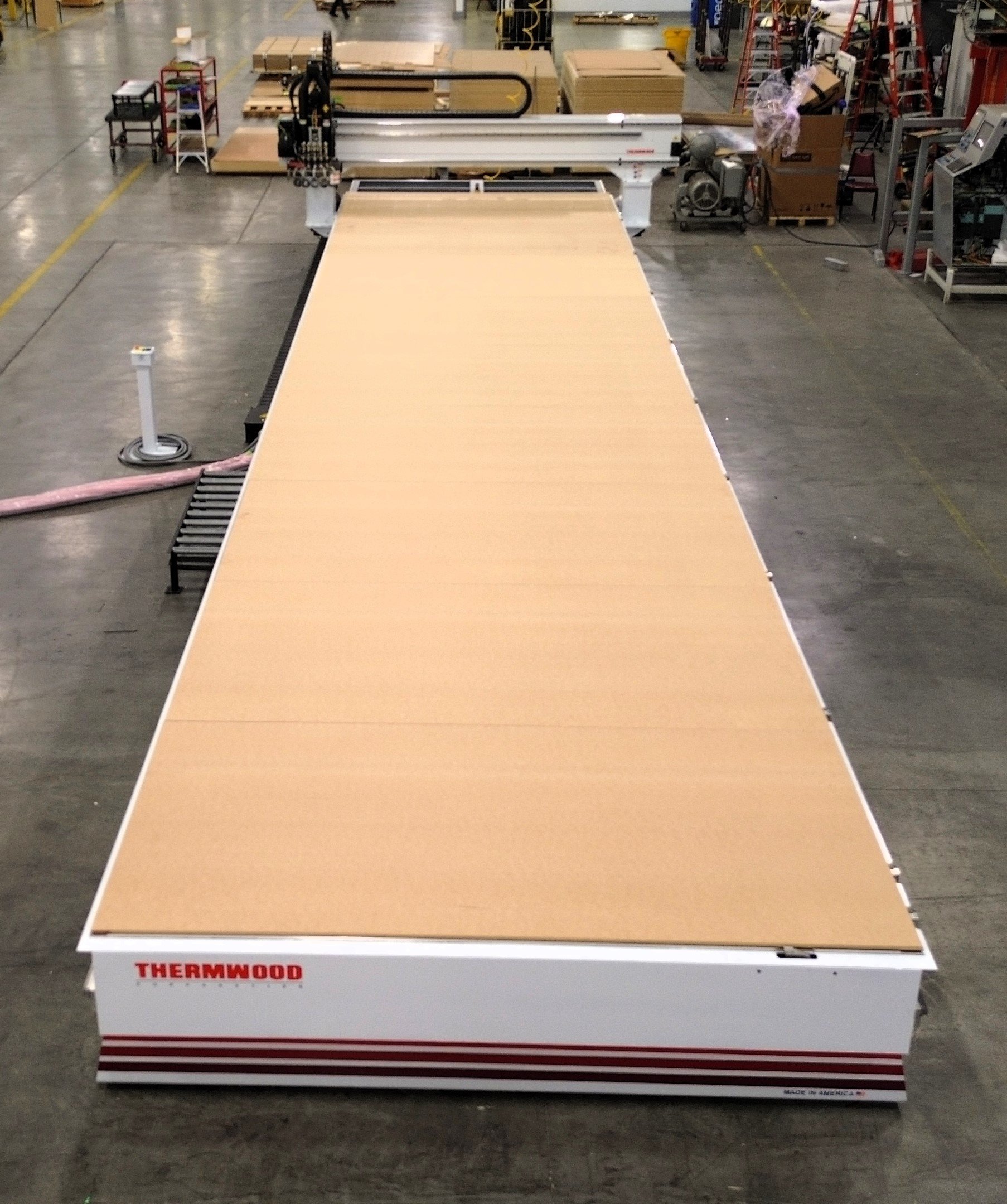

The Thermwood LFM Series are large bed 3 Axis CNC routers with a moving bridge & stationary table designed for two and three dimensional machining of large composite parts & three dimensional patterns.
LFM Info Request
FEATURES
  • Fixed Stress-Relieved Steel Table (10'x45' Length Shown)
  • (9) 5'x10' High Flow Vacuum Zones (on Model Shown)
  • Moving Gantry
  • 18 HP 24,000 RPM Variable Speed Router
  • 5 Position At the Head Automatic Tool Changer
  • Fast Indexing Speeds of over 3,000 IPM
  • High-Tolerance Tool Length Sensor
  • 11 Programmable Pop-up Pins for Ease of Part Location
  • Total Automatic Lubrication System

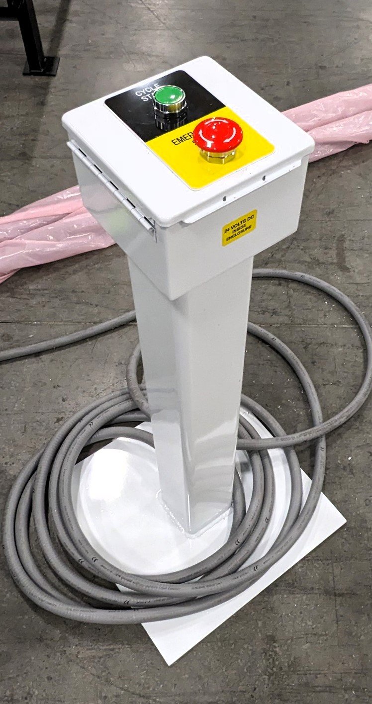

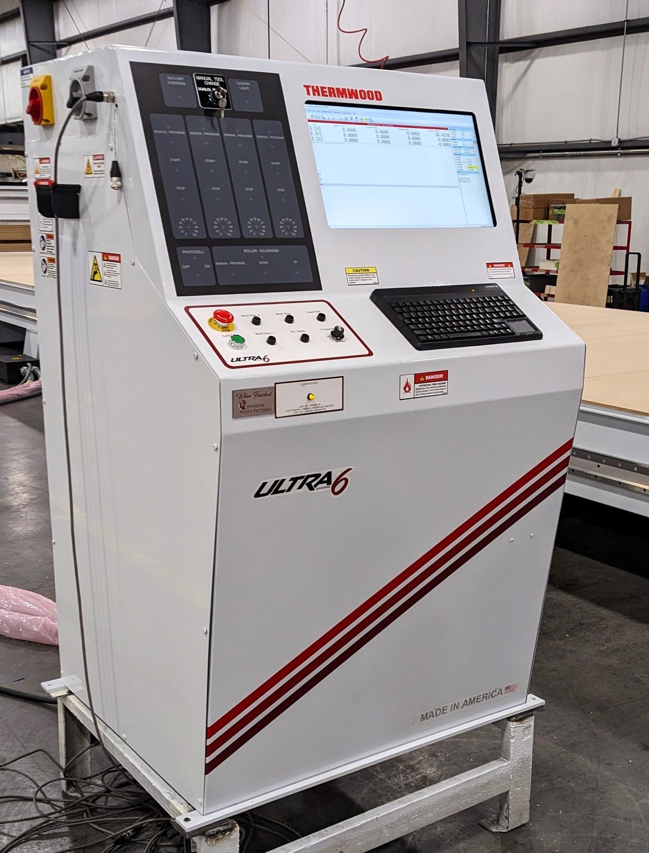

  • Touch Screen Ultra 6 SuperControl
  • Remote Start/Stop Pedestal
  • Wireless Probe Position Verification System
  • Three Dimensional Laser Compensated Axis Alignment
  • 1 TB Solid State SATA Hard Drive
  • Air-Conditioned Control Cabinet
  • Solid State Memory and Control System (fully diagnostic)
  • Multi-Core Processor
  • 22" Wide Full Color LCD Monitor
  • Network-ready with Enhanced Network Filter
  • Free Forum and Phone Support
LFM Info Request

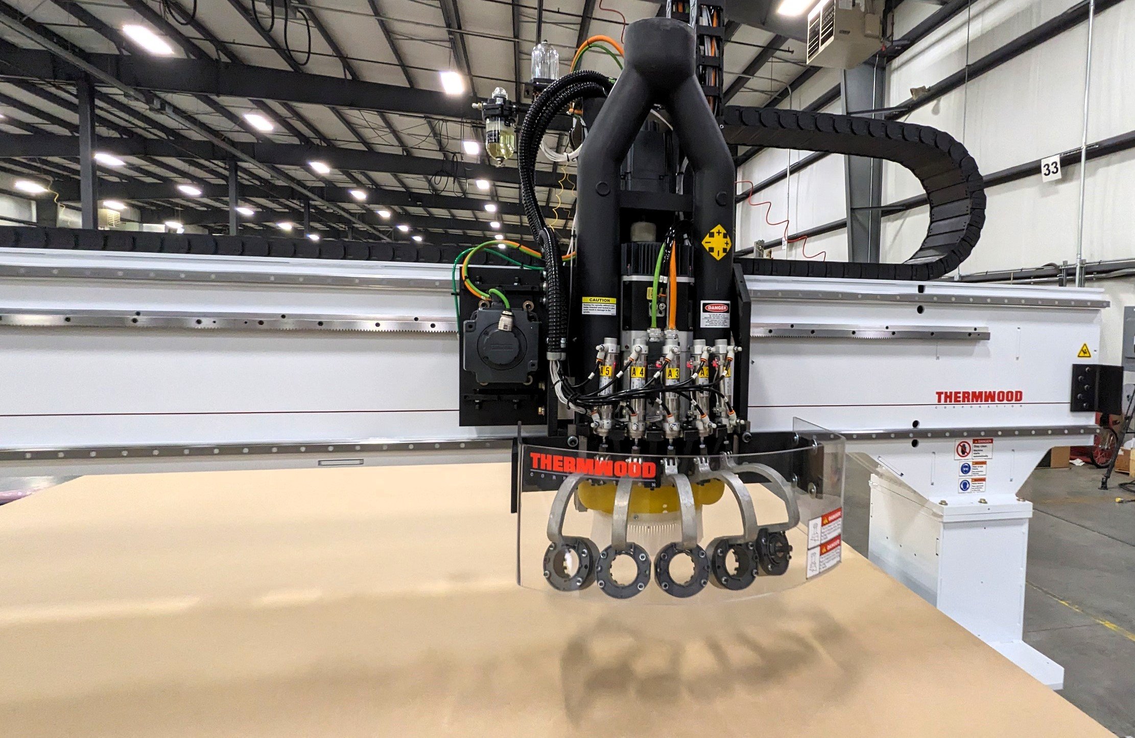

Thermwood Model 77 5 Axis 10'x30' CNC Router
Posted by Duane Marrett on Mon, Nov 20, 2023
Tags: Composites, aluminum, 5 Axis, aerospace, Model 77, Large Scale

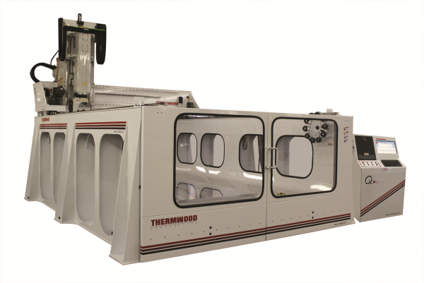

The Model 77 is a heavy-duty high-walled contained system for the machining of large composite and aerospace materials.
Available Table Sizes:  5'x10', 10'x10', 10'x20', 10'x30', 10'X40' and up in 10' increments in length Table Extensions available up to 100' (18m)
FEATURES
  • Open Format for Roll In/Roll Out Fixturing
  • Moving Gantry
  • 60" Z Axis
  • 13 HP 24,000 RPM Variable Speed Router
  • 12 Position Under Gantry Automatic Tool Changer
  • Cold Air Gun
  • Gantry Lighting System
  • Fixture Placement Compensation
  • Constatnt Tip Speed Machining
  • Tip Center Rotation
  • Programmable and Controlled Five-Axis Motion

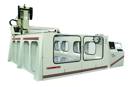

The Thermwood Multi-Purpose Five Axis Series combines all the elements needed for the machining of large aerospace and composite materials as well as trimming and machining large format patterns and molds/plugs for the aviation and defense industries.
Here we look at the Thermwood Model 77 and Model 70.  These heavy-duty, high-speed, moving gantry machines are ideal for machining of large applications using large/heavy fixtures.
Multi-Purpose 77
The Multi-Purpose 77 is a heavy-duty, high-speed contained system for the machining of large aerospace and composite materials (various sizes available):
Features:
  • 12HP HSD Tool Change Spindle (3,000-24,000 RPM Spindle) (other spindles available)
  • Impact Resistant 5 Axis Head
  • 36" Z (other sizes available)
  • 10 Position Rotary Tool Change System
  • Full 5 Axis Simultaneous Motion
  • Fixed Drill and Tapped Aluminum Table
  • Conventional Style Vacuum Plumbing
  • Heavy Duty Access Doors
  • Tool Center Point Programming (TCP)
  • Rapid Speed: 3500 inches per minute
  • Moving Gantry
  • Thermwood Q Core SuperControl
  • Volumetric 3D Laser Compensated Axis Alignment
  • Automatic Tool Length Sensor
  • Chip Collection
  • Multi-Function Nemi Pod Table
  • Free Lifetime Phone/Forum Support
Thermwood Model 77 5x10 CNC Router
Model 77 10x20 Fixed Table
Videos (please click images to view videos on our blog)

Model 77 Standard OptionsAbout the Model 77 CNC Machining Center:
The Thermwood Model 77 5x10 (larger sizes are available) is a heavy duty five-axis CNC router specifically developed for three dimensional machining. This stationary table high wall machine was designed using advanced 3D software utilizing Finite Element Analysis. All major welds including the base and gantry are stress relieved to provide long term stability. This machine is inspected and calibrated utilizing a precision volumetric laser system.
Features:
• 12 HP (3,000-24,000 RPM) Spindle
• Moving Gantry
• QCore SuperControl
More information can be found here
Features:
• Moving Gantry
